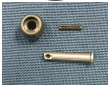

My stove is very heavy duty 5/16" steel stove. The welds are done very nicely like they use robotic welders but not sure they could have been hand welded. The door latch on the Myriads are a nice type setup cant say for other drolet stoves.
The bypass damper is a nice feature and the stove radiates heat really well which would be good for a basement setup. If your basement is large then the larger drolet ht2000 might be better but my Myriad stove throws so much heat that I open my french doors that leads to the garage part of my basement from my family room to vent some heat.
Here is a rebuild kit for the latch so its very serviceable and you can see high quality parts. The ball part rolls on the pin as you lock the latch in place and makes for a good latching mechanism.
