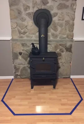

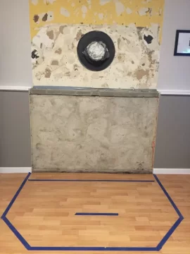

So.. I just tore the brick off the wall tonight to get ready for the new stove install and had a couple questions. I have the Drolet HT2000 on order and plan to install a hearth and redo the terrible brick on the back wall. My house is a bi-level and the stove is in the basement so the upper half of the wall is drywall and the lower half is the concrete foundation. I plan to cut the pergo floor out and put a nice sized hearth in. The floor is also concrete. My questions are.. Should I install .5" Durock over the concrete floor as well as on the foundation wall and over the drywall to give me a nice surface to work with or just over the drywall? I plan to install veneer stone on the wall and tile on the floor as the hearth. Also, I was wondering if I should go with 45's for the stove pipe instead of 90s. I would appreciate any input. Thanks!

No need to put the cement board on top of the cement floor. I think I would remove the drywall in that area and replace it with cement board. How tall is the chimney that the stove will connect to? Is it masonry or insulated metal pipe?

The current drywall over the foundation is around 2.25" out from the foundation wall I exposed. Any idea how I can make up that difference so my stone veneer is somewhat level with the current drywall? Would concrete board be the only option? How could I affix that.. I would like to get the stone even with my current wall in the basement. Thx

I would consider gluing 0.5" urethane foamboard onto the foundation and screwing the cement board directly through that into the foundation with masonary anchors like tapcons. 0.5" of urethane board plus 0.5" of cement board leaves you with 1.25" to install 1.25" veneer stone in- so it would stick out a just a little (because of the thinset).
Note that I have no idea if this is legal or if it's a fire hazard in a stove surround application, but it sounds good to have a lil insulation back there.
Roxul Comfortboard IS is safe for heat and available in various thicknesses including 2".

Cool! Thx for the tips guys. Any other advice on how to mount the concrete board over the foundation wall? Not sure Screwing into the foundation wall will work too well with the comfort board behind it. Metal studs turned sideways? I was thinking 1.25" metal studs mounted to the foundation wall with some comfort board in between and hardy board over top. Possibly 2 layers which would give me my 2.25". May put trim around the veneer stone which is why I'm okay with the extra space of the veneer stone.
Yes, metal studs would also work.
