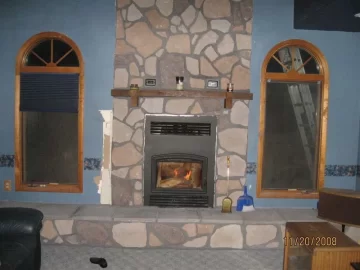

I had a similar situation. Mine was a ZC Heat-a-lator fireplace installed in an un-insulated exterior chase, also in a great room with a sunken floor which added to the problem. These are some issues to consider. If you have a chase like mine, you will still end up with cold draft problems and maybe flu draft &/or cresote issues. I read the instalation manuals for probably every insert on the market. They all say that when installing into an existing ZC, the air circulating vents MUST be left open. That sounds like an ugly install to me, not to mention a possible entery for drafts. After MUCH research and contemplation, I decided to tear the whole darn thing out and replace it with an air tight high efficency ZC. It cost me plenty, but I am very happy with the results. I estimate it provided 90% of my winter heat. I did all of the work myself, and I would be happy to provide more info. Just ask. I learned tons from this sight during the entire process and now feel the need to "give back".
Good luck!
  • [Hearth.com] need some good advice.............newbie here

Maybe the photo angle, and no offense intended, but something don't look plumb there. Either the windows or the fireplace?
Maybe just my perception?
Love the stonework btw. ;)
Everything is plum (close enough). Must have had one to many beers before taking this picture. Thanks for the complements.
