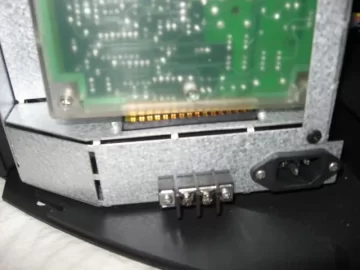

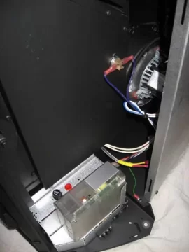

How do you hook up the remote thats wireless. the instruction really don't help all that well.
Thanks I took some Pictures to help. It looks like it would go right where you would put the hard wires that come with it.

See that screw block below the control board? The two center posts are for the stat (which is explained in install manual for the stove)
Just cut the ends off the red remote wires and either put new spade ends on or just wrap the wire around the screws and tighten them. Doesn't matter which wire goes where, as long as one is on each of the two center posts.
