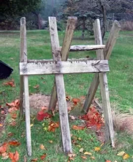

I built a rig like that to hold small limbs and pieces of deadfall from our property. Does the trick.

Yep. A sawbuck has been getting it done for a couple of thousand years now.

I like BG's rig. Time tested technology. I don't think there's a safety issue, Dylan. You can set the saw down while it's idling without putting yourself in any danger (contrary to what the chainsaw manual says). If you want to take it to the extreme, you can engage the chain brake before setting it down.

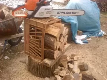

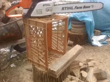

I put 2 large diameter logs on the ground, and place the piece to be trimmed on top of the two with the end hangin over and trim it. just make sure the two large pieces are stable----I place an already-trimmed piece on the ground as a "ruler" to get the correct length. I trimmed everything to 18" If you have some longer pieces, you could just half them

Nate, many of us has cut wood down low but just throwing it on the ground would be a sorry way to cut off lots of these things. Also, not everyone would be able to do this without kissing the ground with the end of the saw so would get lots of practice shrarpening! The ideas of building a jig or even the milk crate idea works much, much better and is a whole lot faster to boot.
by the way those shorts on the ground were all I had to burn for quite some time, loved them though was like burning coal.
I use my miter saw but I'm liking wood fanatics milk crate rig
