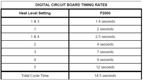

Auger should be cycling so many seconds on and so many seconds off. I will see if I can find a chart for ya!
  • need voltages for breckwell p2000 combustion blower

With some math, I figure you should see a full rev every 72.5 seconds on heat setting 5(This would be for the digital boards) and auger cycling on and off. Your getting a full rev in 52 seconds? Hmmmmm! Don't sound right!
