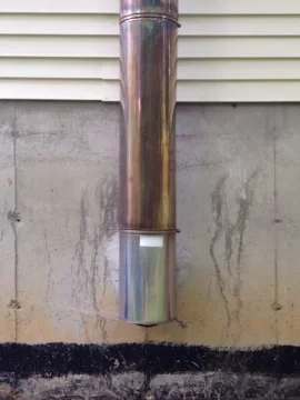

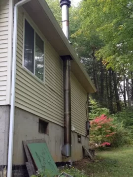

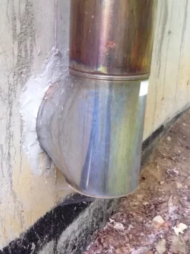

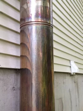

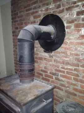

I took a few pics to show what my setup is...
[Hearth.com] Need your help please,is this a good price?[Hearth.com] Need your help please,is this a good price?[Hearth.com] Need your help please,is this a good price?[Hearth.com] Need your help please,is this a good price?[Hearth.com] Need your help please,is this a good price?
If you're not ever going back to wood, you might think of removing ALL of it & selling it to offset the cost of the pellet vent.
A 4" liner is probably $500. 3" pellet vent up & out (& maybe up again) might be half of that...
'Course you've got a couple of holes in the roof & soffit to repair
& you may need more hydraulic cement to seal the PV where it passes thru the foundation...
I definitely won't be going back to wood since we put a new addition on home, which is why we are switching to pellets. So does anyone think its possible to remove a portion of the chimney or will it all just tumble down to the ground? I know its braced pretty good up on the roof. To avoid having to fix that hole in the roof from the chimney, I guess I was thinking of removing a portion of it, and then just putting a 4" line insert into the part that is still existing below.
I ripped my wood stove pipe out completely... much cleaner looking. Not a terribly difficult repair job on the roof. You will enjoy not climbing up a ladder to clean the pipe. Mark my words.
Reactions: DAKSY
Even if i took out the existing chimney, I have no clue how I would get the outside air kit setup since I'm dealing that concrete foundation wall. In my head its tough to justify paying $1K, when the englander will cost me the same. Sounds ridiculous..
That $1k has the $500 liner in it.
New pellet vent - thru the existing foundation hole with a fresh air attachment,
might cost you $500 TOTAL, probably less.
