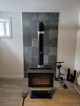

Hello,
We are in deep need of help. We are pretty sure we have a negative pressure issue. We have been able to light up fires( this goes well when we open a window beside the woodstove). It burns well. BUT as soon as the chimney gets cold again we get that backdraft. Cold air coming in and nasty smell in the basement. The stove is new. Got the chimney cleaned before the winter. We have NEVER had this much trouble with a woodstove. And, the problem isn't always just when theres a lot of wind..feels like it's really sucking air from outside to bring it inside. Anu suggestions? It's an exterior brick chimney, thank you

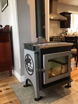

I have an Ideal Steel and a ERV, that we set up with a slight positive pressure. I also have plumbing for an outside air kit that I have not attached to the stove. I purchased the stove with an outside air attachment, but because of the ERV, I do not need it because I have excellent draft, sometimes in deep cold and high winds almost to much. The fan speed on the ERV was set by our HVAC installer. It is a basic dumb unit, that you set the switches for the exchange rate. I keep it on all the time except when we are cutting hay in the summer because of the extreme dust in the fields around our house When cutting bailing. Our house is tight spray foam, walls, r25 blown attic r50,
We tested our stove with three bathroom vents on and and running the IS had no stove issues, however, even with the + ERV pressure, since it is only slightly positive, I have to be careful when cooking. In my kitchen the cooktop is 15-20’ from the wood stove stove, and the cooktop has a large commercial 48” high speed hood, I can only turn on the hood to the first two settings when running the wood stove, I never turn on the hood to level 3/4 (750 cfm and 1200 cfm) because the draft reduces on the IS, and I get a very rare occasional back puff when the hood is on high. (build up of gases inside the stove box) nothing loud or bad, never smoke puffed into the room, but just a quick extra gas ignition poof.

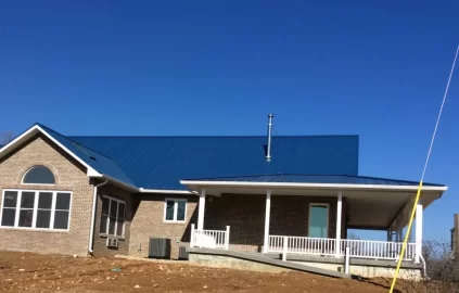

sure, Our new home was built and we moved in March 2018, stove arrived a few months later. We ordered a custom artwork Ideal steel unit, and I had the builder install the chimney, and placed cement board behind the stove location, and two layers of board and tile underneath the stove while the home ws being built. I did my homework, researched erv units, , and fortunately, the local builder listened to me and these custom features were part of our build. We bought our farm 10 years earlier, and when we retired, moved to the farm full time after retirement. There was an old “farm house” , but the quotes mean glorified camping, small 900sf 70 year old building, nothing for perm use, so we tore down the house and built on the same spot.
anyway…. our house was set up with a + pressure on the erv unit, because we knew a wood stove was going to be installed. When the stove arrived that summer, I waited for first burn until the first Winter. During our first burn in fires, I did not test the range hood, or bathroom vents when doing the first few days of firing and burning in the paint.

pick of our stack and how close the hood is to stove.
