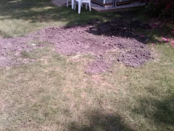

Hello
Well, The new grass finally grew over the Electrical Trench!
It needed new loam, starter fertilizer and grass seed!
