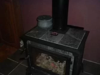

Hi Dottie. I can't help you with the stove problems but I'm sure you will find plenty of help here. I just wanted to share with you an easy idea for forcing some of that warm air into your other rooms. I have my stove in a small room too (12x14) and my kitchen was never warm enough while my stove room was very warm. I installed an inexpensive through the wall vent fan and it made all the difference. I opted for the plug in model since I'm not handy with electric and it was very simple for me to do. The pictures show both sides of the fan. You can barely see it, but I have a hallway beside the stove room and the air never made it down the hall to the kitchen by itself.
