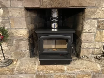

I just finished up the install on a new buck stove 21 insert. The shape of my existing fireplace requires the insert to stick out a little from the face of the fireplace. I couldn’t bend the flex liner enough to attach directly to the stove. The 30 degree elbow allowed me to make the connection. As I am new to this, I just wanted to throw a photo on here and see if any one sees any problems with my connection and set up.
I’ve learned a ton by perusing this site for the past few months while planning and, purchasing, and installing. Thank you all! Hoping to fire it up this weekend for the first time.

Nice clean install. It looks good there.
Is this an exterior wall fireplace and if yes, did a block-off plate get put in?
I did not make one yet but I have ceramic insulation in the cavity for now
Chimney is internal.
For an interior chimney may be sufficient. Try it and see.
The insert sticking out a little is a good thing. It's going to put more heat in the house.

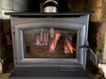

Well unfortunately it seems I have some major draft problems. Smokes and smolders forever. Takes a long time to get started. I cant even crack open the door without smoke coming out of the flex pipe connection and when I open the door even further smoke just rolls out the door opening. Chimney is 15’ and I even scrapped on an extra 3’ temporary piece at the top to see if that made any difference. Nothing. Very frustrated.

Thanks for the tips. I have cap removed now. It’s burning ok now maybe but I’ve been working it for the past hour. I still have the air wide open.

It’s cherry I think. split and sitting under a roof for almost two years now. Fresh split on my meter said about 17%. Flames have now gone out

I put a few 2x4 extras in there awhile ago. Those burnt very well and I even saw the secondary tubes working with them. I will assume the wood is one of the major factors. However, I still get tons of smoke coming out the door when I crack it.
