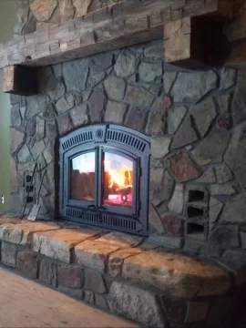

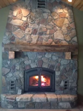

Welcome to the forum! I installed a Napoleon NZ3000 in our living room rebuild and we LOVE it....it's a real heater, that's for sure....
But it is expensive......
View attachment 108462 View attachment 108461

WOW..........great taste in design.............very nice.
Heh.........Looks so nice it makes your freestander look dated .;)

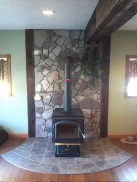

I originally built that kitchen hearth with the intent of someday putting an Esse Ironheart on it......
But wifey and I were perusing the 'net this afternoon just looking and we found this one that really caught our eye....and it would fit PERFECTLY on our scallop kitchen hearth!!
Now your talkin...............That would be a beauty sitting on that hearth

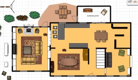

Here's the basic floor plan of the first floor. (Second floor is same footprint as the first floor, minus the addition, with 4 bedrooms, 2 baths.)
First floor ceiling height is 8'. Family room addition (18x22' on left) will have 10' tray ceiling (10' center, 9' around edge). There will be a large, probably 6' doorway into the kitchen. There will be a smaller, 3.5' doorway into the dining room.

Too bad you don't want to supplement more heat with a stove; That looks like a workable layout. I'd guess your wife would get more comfortable with fire after witnessing how safe a stove is for a while. But maybe not, and maybe never any serious heating would be possible.
