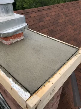

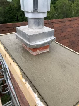

Now on to our cap, we had the mason come and fix it as the original cap was just six window sills without a drip edge. The mason poured in a new cap but to me it looks a little flat without much of a slope to it. I will be following up but I don't know much about it or how big of a slope is needed.

The slope is probably fine. The lack of a bond break between the clay liner and the crown is not ok the crown will crack

Well great.... Is there anything they can do to solve the issue? Or is a re-pour required?
I assume you mean like a sill gasket between the clay liner and concrete?

Yes that is what we use. The only option other than a re pour is removing the clay going through the crown because it isn't needed with a liner for an insert

The simplest solution is remove the clay going through the crown. Leave the crown as is then install an insulated liner in the chimney with a top plate that covers the hole left by removing the clay

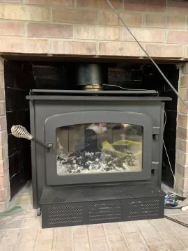

The air control is part of the stove. A damper is added and is controlled separately. For inserts the easiest place is to drill a hole in appliance adapter. It’s not ideal but offers a workable solution.
Some pictures in this thread. There is another thread where a u joint is installed and the damper rod is extended through the surround

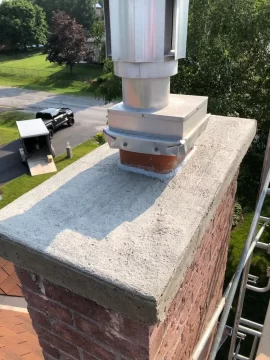

So I think the mason finished up yesterday. There's no drip edge that I can see from the ground and when I asked about it he said he used a wire brush. I was thinking of adding a bead of caulking along the bottom to act as my drip edge.
Then he also caulked around clay liner without the bond break. I posted a pic of the final.
