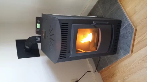

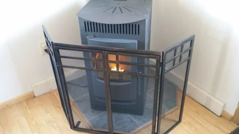

I'll post a pic shortly. rich2500, I haven't messed with the voltages at all so they're stock. Did a clean sweep and vac out this morning before firing it up, seemed to run steady around 88 in the corner today, and just a hair under 80 in the whole room. Wind must have been bad today though as the rest of the house had trouble holding on to much heat, boiler would kick on every so often and it's set at 65. [Hearth.com] New Castle Serenity Pellet Stove [Hearth.com] New Castle Serenity Pellet Stove

Not sure why the second image turned sideways but there it is. No OAK, just pulls cold air from the room for now. Got a second screen to go all the way around the stove, and have a cooling rack with a cake pan of water on top to add a little humidity, might replace that with a catch pan and a sourdough starter(to keep it warm).
looks really good. might wanna get yourself a surge protector though,and get your oak hooked up, since everything is still set at stock best thing to do is try different fan placements,I run a fan sitting on the hopper lid and the furthest room from my stove is 3 deg. cooler . others have had good luck with pushing the cooler air towards the stove.These little stoves really kick out the heat, right now it is 23 deg. outside and it is 78 deg. just outside my bedroom which is the furthest room from my stove, all settings on lowest settings.I have been playing with adjusting the intake air gate(currently 3/4 closed) trying to get my temps down but it don't seem to mean much.I have only had my stove a month and half(been burning pellets for 10 yrs.) so I'm still learning it also.these stoves are so easy to clean, no passages anywhere except the exhaust under the ashpan and that I can get my shop vac hose in all the way up to the fan .
Nice stove - you'll have to figure out the best way to move air in your house. Depends on the lay-out - lots of threads to search on the forum... May have to take a good look at your insulation to keep that warmth in.

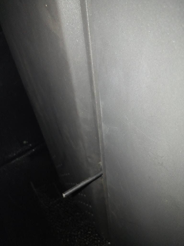

Intake air gate is adjustable but need to remove side panel to adjust it(put a rod on mine that comes out the side of the stove now I don't have to remove the side panel.

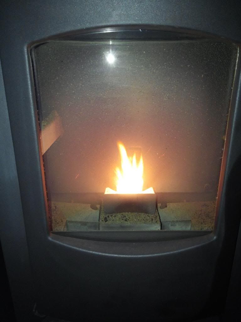

Glass gets dirty quick(not to the point you can't see through but hazy)

I noticed that with the glass too, I just wipe it down each day before I fire it up. rich2500 would like to see how you added rod, might have to see about adding something like that.
Here is the rod out the side.will have to get a pic of how I hooked it up to the gate

here is the glass after 12hrs. of burn time, I burn 80/20 corn blend so mine might be worse then burning straight pellets
