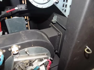

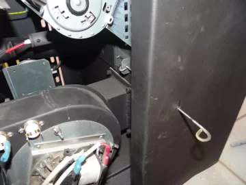

Where is your draft set, I have found that if it"s getting to hot in the house if I open the draft all the way more heat goes out the exhaust and it don't get so hot in the house, with that being said I did install a rod to adjust my draft without removing the side panel.
Reactions: molsonman
Everything is exactly how it came from the factory. My house is a little over 1200sq feet. I'd like to just keep the stove running but at a more comfortable level. Opening the draft should lower it some. Was wondering if there was a way to do that by lowering the pellet feed as well somehow.
Unfortunately there is no other adjustment for the auger feed other then the heat settings.You might be able to install an inline trim switch, I don't know for sure though if that would work.You could also make a plate to sit in the bottom of the hopper that would reduce the pellet feed opening.
I fixed the intake on my stove with a small rod and drilling 2 holes one on the intake gate and one on the side of the stove [Hearth.com] New Castle Serenity Pellet Stove [Hearth.com] New Castle Serenity Pellet Stove [Hearth.com] New Castle Serenity Pellet Stove [Hearth.com] New Castle Serenity Pellet Stove [Hearth.com] New Castle Serenity Pellet Stove [Hearth.com] New Castle Serenity Pellet Stove [Hearth.com] New Castle Serenity Pellet Stove [Hearth.com] New Castle Serenity Pellet Stove [Hearth.com] New Castle Serenity Pellet Stove
