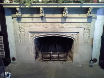

I've attached the fireplace where clyde will be going. Its in the basement and i have been struggling wether or not to cover it with a insert but after being in 3 of my neighbors homes and them not having to run their heat yet this year I'm biting the bullet. your posts have been extremley helpful and any feedback would be greatly apreciated! Oh and have any of you been successfull heating the whole house from the basement?

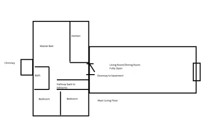

Thanks for all of the responses! So here is a quick layout I drew up. The finished basement where clyde is going is approx. 680sq ft. It is WELL insulated. The original owner was a master carpenter and when we purchased the house in 2012 the inspector said it was one of the tightest homes he'd ever inspected :). I've read a lot about transferring heat from the basement and mstoelton I agree it will be difficult but am wondering with the close proximity to the stairs if that will help. The other thing to keep in mind the main thing you guys can't see in the drawings is that we had a central hvac system installed last year so right now I have a bunch of areas in the ceiling in the basement opened up to accommodate the the duct work which I am hoping will allow more transfer, not sure if I'm trying to will the heat upstairs or if I'm safe in my assumptions:rolleyes:. The shop area is completely closed off to the finished area and that is where the central hvac system is located so that stays pretty warm anyway.
One other thing I've noticed in reading the other posts is heat transfer upstairs using fans or other means to get cold air to the unit. I have the 2 vent caps you can see at the bottom right and left hand corners of the fireplace that are piped outside and am wondering if that would be enough to allow heat transfer upstairs or do I HAVE to bring the cold air down from upstairs?
Total sq ft of living area including basement 2508

If that is true you may get problems with draft. Any way you can supply outside air to the fireplace?
Hi Grisu, if you look at my avatar there are round caps at the bottom right and left hand side of the fireplace, they are vent pipes for the fireplace. Would that suffice?
Also we had a energy audit done before we installed the geo system and they required fresh outside air. We had a fresh air circulator installed to accommodate the need but not sure how that will work since it circulates the whole house and I can't regulate it to a specific area.
Correct me if I am wrong but it looks like they would be pulling air from the inside. If the whole house is airtight you will have trouble getting a good draft going. You would need some air coming from the outside going into the firebox cavity close to the air inlet of the Clyde.
My house is ICF (Insulated Concrete Forms) construction and anywhere we could not use ICFs and had to stick frame we sprayed in Icynene foam including the roofline. We also have high-end energy efficient windows throughout. You won't find a house much tighter than mine. We had to install a mechanical air exchanger based on the recommendation from our HVAC contractor and a requirment from the building inspector who was not going to pass our final inspection without one. As tight as our house is, I have had no problems with draft. My concern in your case would be getting the heat out of the basement and to the rest of your house.
Actually they pull the air from outside, I pull the caps off and its 3" copper piping going through the wall to the outside and is capped outside with screened vents. When I start a fire you can put your hands in front of them and feel the air coming through quite well. The original owner said he put them in to cut down on the heat loss up the chimney. A open fireplace is an open fireplace, your going to lose more heat than you will create but i'll give him credit it does actually heat the basement fairly well when I get her roaring.
