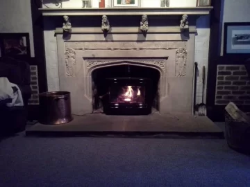

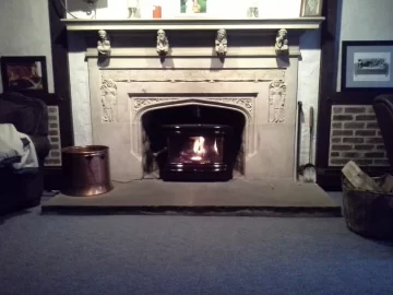

Here is the unfinished product. As stated above they will be back to install the factory surround as well as the surround extension along with new blowers. Right now it is all the way into the firebox, the installers are bringing a elbow so it can be brought out onto the hearth. I want it as far out as possible to maximize radiant heat as well as convection from the blowers but at the same time minimizing any hard bends in the liner.
I ordered a small 10" fan for the top of the stairs to blow down to the insert. Every night I load up around 10, I have to monitor it pretty closely since I dont have the blowers to cool it down in case of over-fire. I also have the Condar Inferno, gave myself a little scare yesterday morning when I loaded it up and opened the damper all the way for about 30 seconds, closed it down and it went up to 725!:eek: i opened the door all the way and it slowly crept back down to about 675 so lesson learned! Funny thing is i will have to re-learn all of this once the blowers are functional since it will probably run cooler. So far i come down to a bed of 2" diameter hot coals, rake em' out and load er up every morning. Inferno reads 175 and the basement goes from 72 when i go to bed and its at 65 in the morning. I am only burning white ash at a MC of 15.5-18.5% and let me tell you, once it gets going i can throttle all the way down and watch the flames tap dance all over the place so yes, very hypnotic! I will update as things progress!

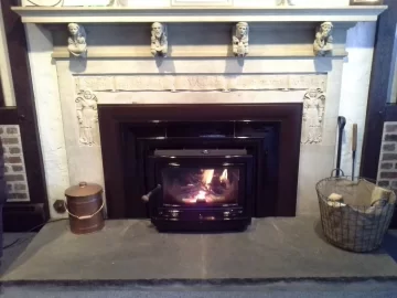

Looks great! The mantle is very ornate and looks like a work of art - That is some basement. The blowers definitely keep the temp of the unit in check. When I get close to the high end of "best" on the thermometer, I crank up the blower and it settles down a little, but that does not happen often. Keep us posted.

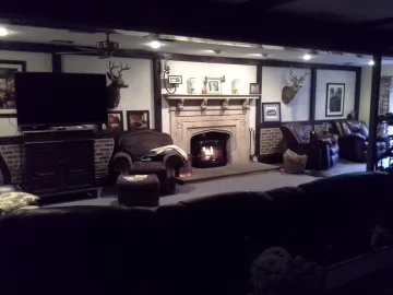

Well, here it is. Finally finished!
Some observations about the Clydesdale:
Beautiful insert, firebox is a nice size and if well packed, will give you a nice bed of coals at the 10 hr+ mark.. I've noticed some posters have said it doesn't fair well with n/s loading but I have to say that I have some 12" cutoffs from the ends of logs that I lined the first level n/s and the rest e/w and find that I get more of an even burn and less large chunky black coals in the back the next morning. I know its states 10 hr burn time but I have honestly loaded up at 10pm and didn't have a chance one morning to restart until 11:30 and still had enough coals to get her going again so pleasantly surprised. Only have burned ash so far and im sure with some well seasoned oak I could probably get a little longer burn times.
Overall I'm satisfied with the investment, in a perfect world I'd like to get a little more heat transfer upstairs but I realize now that fans can only do so much but I do notice the intervals in which the heat kicks on is longer than usual. My last electic bill before the insert was $355 and I'll give an update to the savings once I get the next bill.
Thanks again for everyones help, my wife and I are happy campers!
