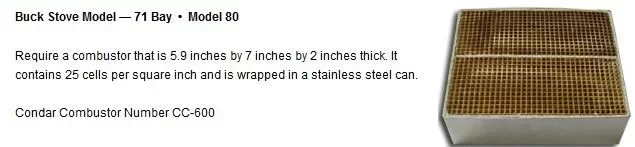

I understand that the catalytic metals aren't cheap, but I spent hundreds of dollars on this thing. Maybe I'm way off base on this. I saw one on Condar's site (made by Sud Chemie?) that had similar thin spots in the coating, but not to this extent. Maybe it doesn't mean I have a sub-standard comustor; It's working fine...so far. If it craps out early, though, I'll certainly be calling in the warranty...
Condar site pic:
Condar site pic:
