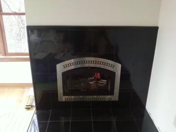

We just finished this install in a new home. This one is called a Fireplace Extraordinaire. They are catalytic and will put out serious heat.

cmonSTART said:
What does something like that cost, webby?
Can't remember for sure, I think it is in the $5,500-$6,000 installed. This is the FPX 36, if you wanted the 44 the price jumps by several hundred. The price also depends on how tall the home is, you can also save some coin by choosing a black face.
