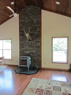

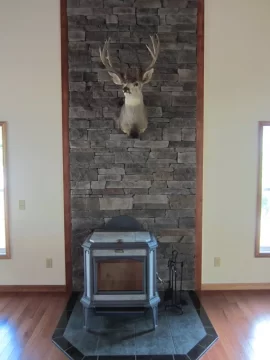

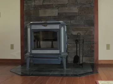

Hi Angela, Congratulations on the new house. I too just finished building a new home in NE Tennessee on the side of a mountain. I would have loved to have gone Geothermal, but because on I am sitting on bedrock, the upfront drilling costs were very high. Instead I decided to go with a high efficiency heatpump. Because Geothermal is so low cost to operate, I would concentrate more on looks for the wood burning application. In my case, originally I was going to build a large stacked stone fireplace in my great room. However, after reading a lot of threads on Hearth.com, I changed my mind and went with a Woodstock Soapstone Progess Hybrid Stove. I love the way it looks and hopefully I won't be spending a lot of time reloading it because of the longer burn times. Anyway, whatever you decide on, I'm sure it will be great.

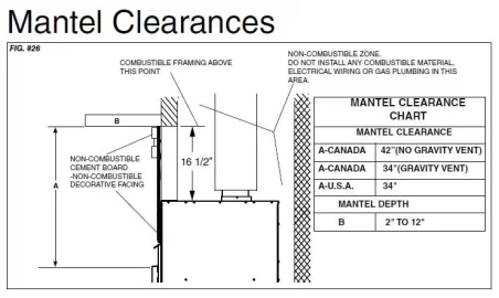

Hi guys! thanks so much for the info. We spent today at Tri States Stoveworks in Iowa, as it happens they deal in all three models we are considering. The rep was there from FPX and had a LOT to say about new construction. He gave us articles on the air exchange issues - lots of great input that we had never considered. Who knew a tight house could be a bad thing? Of course, he thinks the FPX is the best thing since sliced bread - and we can't argue that. But they sure are proud of 'em! Roughly $1K more than the other two. I'm leaning toward the PE unit, and yes, I like the clean look. Now, here's a new issue I'd like some feedback on if you would be so kind. My husband really wants a wood mantel - old and weathered if possible. But he doesn't see the need for the 24" clearance thing - he's sort of pooh-poohing it... thinks they are overcompensating due to lawsuits, etc. Anything to say on this issue? He thinks if we keep the mantel no deeper than the stone façade we don't need to worry about it. Guess I'm not so sure...thank you again!
The minimum mantel clearances are not to be fooled with. They are lab tested and not by lawyers. Most of the heat is going to want to go upward. It needs space to mix with the room air and cool a bit. You want to meet or exceed all minimum clearance requirements. This is a safety issue and should be required to pass inspection and for home owners insurance.
That said, the clearance doesn't appear to be very high. It is 34" from the hearth to the mantel. If the hearth was raised say a foot, that puts the mantel at just under 4 ft which visually would be about right or even a bit low. If the mantel is flush with the stone veneer, what is the goal, a visual break? If the mantel must be lower, perhaps make it out of stone.
Agree--don't mess with clearances. They are done by engineers, not lawyers.
OK! Husband bob says, "I give!" The Alderlea has a more forgiving clearance - the FPX 36 requires 57-1/2" from base of unit, add a hearth of about 12" and that puts a wood mantel up in the air pretty high - about 6'. I told him I was OK with stone mantel, but he doesn't like them. So - he just has to choose! (btw, I REALLY appreciate the back-up, guys.... I'm a chicken about bending safety rules & always wear my seatbelt! ;) and just think, I thought I'd be spending all my time picking out towel bars and light fixtures.... one thing that's been kind of fun - the FPX rep asked me, "Am I giving you too much information too fast?" I told him I'd read through the installation guide three times so far, so, nope, I understood what he was saying. (LOL) Again, can't thank y'all enough for weighing in on this stuff. I'll be sure to post some pix when it's in - here are some pix of the house in progress anyway. Roof truss system is arriving Wednesday. We're meeting with the geothermal guy this week to have a little face to face about air exchange and negative pressure...
