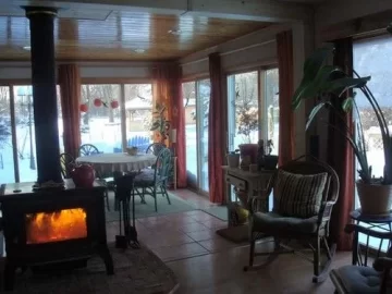

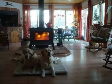

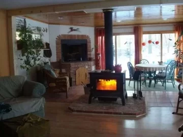

Our home is 2 story with 1/2 basement at 2900 sq.ft. We installed our Hearthstone Equinox soapstone in the center of our living room(see pictures). We love the fact that we can sit around it and it heats the room(800 sq.ft.) to 74-80 depending on how hot I burn. It is quiet (we decided to forego the blower). Heat moves fine. Upstairs bedrooms (68-72). The stove actually sits in the foundation wall in the basement, but you should be fine ( what width are your floor joists). Ours weighs almost 700 pounds.plus the bricks for the hearth. Sounds like you are going to have a real beautiful place.

jlow, your stove and house look awesome! I don't know if out in the middle like that would work for our application.

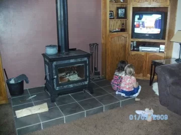

Here's a picture of mine. It's a heritage that is 10 inches from the wall vs. the 7 minimum. The stove sits very close to the wall but the hearth must extend out front due to the front door. If the hearth was not raised it wouldn't matter but due to our raised hearth the heritage takes up as much floor area as a fireview even though the fireview has a huge rear clearance requirement but since no front door there is very little hearth required out front of a fireview. The soapstone is very pretty and does not heat you out of the room. It is cranking away in the picture keeping the house warm.
