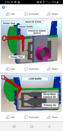

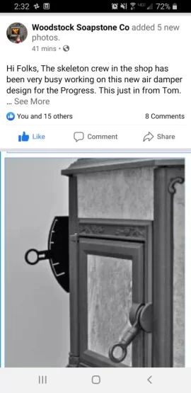

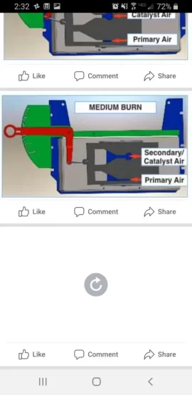

Just saw this on facebook. It will hopefully address the biggest flaw with the stove IMO.
Hopefully it's retrofitable and not too pricey.

Can you detail the problem?
Currently the damper adjustability is not good. You see very little reduction in airflow until nearly completely closed down. With my setup just cracking it a little will result in too much airflow. So for me currently the stove basically has full power or fully shut down.

Thats the beauty of slide mechanisms like what the new PH control is. You can optimize the airflow vs damper setting via how you cut the hole in the slide plate.
The only better mechanism (assuming an optimized slide plate) is a thermostatically controlled damper like blaze kings.

I seen the diagram, but can someone show me an actual picture of the control, as well as the primary and secondary air intakes on the Progress.
EDIT:
Nevermind....I see the control. All I'd like to see now are the air intakes.
