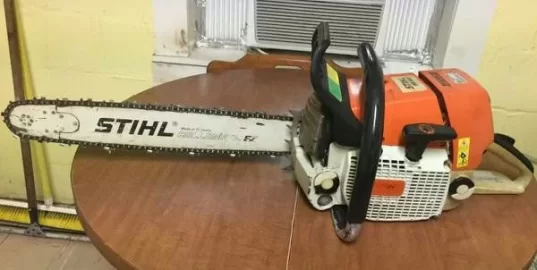

Not concerned with selling it later, as soon as I do I would need it again. 5 year warranty goes a long ways though. I plan on running around a 24" bar. Here are some pics of the stihl. [Hearth.com] New echo or used stihl[Hearth.com] New echo or used stihl

That's not what I'd call "barely used," but neither does it look abused. $500 is a fair price if it's in good operating condition, but not a steal.

Yeah the ad said barely used but now that I zoom in on the photos I see some wear. The echo is rated for a 27" bar but I think a 24 would be all that I want to run .

Is that the original bar ?
If that's the original bar then that saw has not been used for much more than blocking logs set up on the ground. Reason I say this is the paint on the bar. It's mostly all still there. In my experience, as soon as you start getting into big wood, and doing stump work where the heavy trunk sits on the bar, the heat generated takes care of the paint on the bar. Quickly.
I believe it's been used but has not had a hard life in a production environment. It looks not that used to me.

Tough decision. $500 is a lot of cash for a used saw if you don't know the seller, and the saws history. Nonetheless the Stihl in that picture doesn't look beat up and like I said I think if the bar is original it's had an easy life so far.

I will agree with WARRANTY Value. Warranties are written to protect manufacturer, not consumer. I have worked on many saws where warranty was denied. Assuming the Stihl has the original sprocket, would be a good indication of usage.
