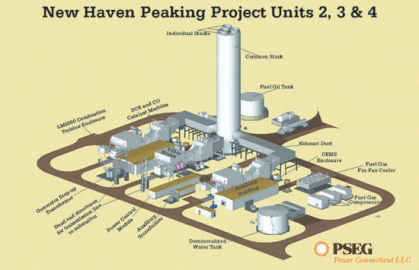

There is a power plant down in New Haven harbor they only use during peak times. It looked like it was running full bore yesterday. Its crazy that it sits idle probably 90 percent of the time and they only use it on the rare days of high demand for a/c.
[Hearth.com] New England Power Prices 8/11
The project added three highly efficient General Electric LM-6000 combustion turbines at the site of the existing New Haven Harbor facility. These turbines use state-of-the-art technology to provide residents of Southwest Connecticut with power during periods of peak demand for electricity.
The new turbines are dual-fueled and use either natural gas or ultra low sulfur fuel oil. These are the cleanest fuels available.
The project included state-of-the art emissions controls that meet the latest environmental standards. A Selective Catalytic Reduction system and water injection were installed to reduce nitrogen oxide emissions by 90 percent or more. A combustion catalyst has reduced carbon monoxide emissions by 80 to 85 percent.
Peaking units can rapidly produce electricity and are most often used during periods of high demand – for example, during sweltering afternoons when air conditioners are in constant use. The GE LM-6000 turbines at New Haven can reach full output within 10 minutes of being called into service.
As peaking units, these turbines operate only during periods of peak power demand. The facility is helping to improve the reliability of the transmission system by quickly providing power when required by the NE-ISO.
PSEG Power Connecticut is committed to providing the state with reliable and environmentally responsible energy.

I tested those units in New Haven (they were right next to I 95 at an old power plant site along a river) when they were new.
Most peakers can run on natural gas but on high power demand days, they typically cant get enough natural gas to run as the region doesn't have a lot of extra natural gas available. The reason they don't run the plants full time is that they aren't very efficient since they are simple cycle meaning they are exhausting 800 degree heat. They are cheap, quick to build and can generate power in minutes.
The most efficient plants are combined cycle plants, they take the exhaust from the gas turbines and then run it through heat recovery steam generators to generate steam which is then run through a steam turbine to generate more power with no extra fuel. In Europe they go one step farther and take the waste heat downstream of the HRSG and heat hot water for district heating systems. They are a lot more expensive to build and take longer to get up to full power.
