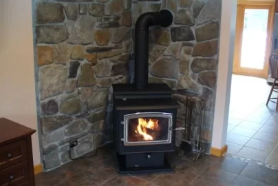

    After a chilly 3 weeks, We got the new Enviro 2100 installed today!
    The installation went well in general, but there were a couple of hitches. One of the firebricks arrived broken and the installer broke another while trying to force it into place. He is going to get me some replacements. He installed the broken ones in the top front. (This stove has a double thickness of firebrick as a top baffle.) That way, I can get at them more easily when I replace them. Installing the top firebrick layers was a bit of a hassle, partly because he needed to trim the back ones with an angle grinder to get them to fit between the welds.
    The second hitch was with the blower thermostat. The blower did not come on during the first firing, even though I got the stove top up to 400 degrees at one point. In checking the installation instructions, it turns out that the installer was supposed to have "adjusted" (bent) the sensor bracket so the sensor would be in contact with the stove back. He neglected to do this. Looking up from underneath, it appears that the sensor is about 1/2 inch away. I'll fix this myself, when I get the stove cooled down again.
    I got conflicting advice from the installer, and from the paperwork that came with the stove, on how much of a fire to run the first time, while starting to cure the paint. I split the difference and used 4 smaller sticks, which burned for about two hours before flaming out to just coals. The photos below include the first fire. It sure felt great to have a wood fire again!

    Great wood stove ya got there. Enjoy.

    Congrats Dennis great looking stove and hearth! Does your stove have the pumice bricks or the heavy ceramic bricks? The pumice bricks are very easy to break as I have replaced the ones in the back of the stove with the ceramic bricks and they should hold up much better. Lots of debate about the different bricks but nothing definitive. My stove runs no different with the hard bricks in the back and I expect the hard bricks to last a long time and withstand any normal log loading impacts..

    Real nice stove and install, Dennis.
    I like the window size....

    That's a really nice stove. Congrats.
