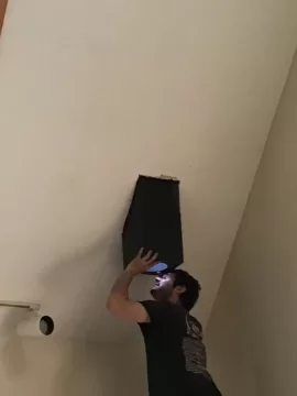

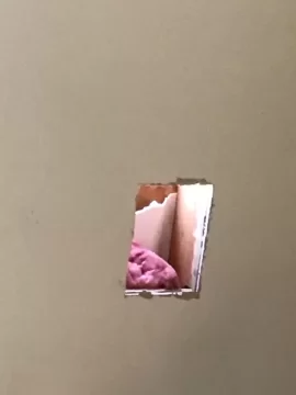

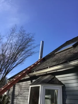

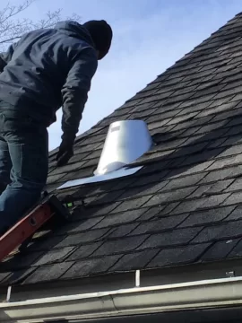

We have installation! Boys were here bright and early and we have a hole in the roof!
I will show pics as the install happens so folks can see that are looking to start out.
Here the box is being prepped
  • [Hearth.com] New F3500 Regency Owner
Reactions: Woody Stover

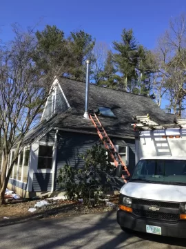

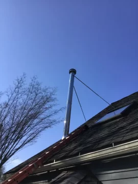

Outside ......:)
Reactions: Easy Livin’ 3000

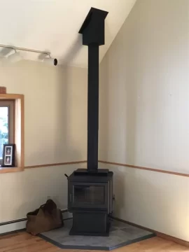

Thats a tall chimney. Any pictures zoomed out?
nice enjoy the heat :)
Thanks! It’s 26 out and just the small break in fires are warming the bones of the house..we have one wall that is almost all glass and has been a cold spot since we bought the home..now the windows are warm on the inside and there is no temp drop right up to the windows!
Sooooo Impressed with the positive warm air induction from the fresh air kit!!

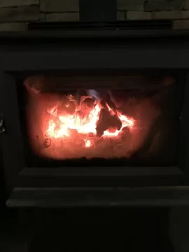

Hey all,
Can someone give me an idea of what kind of temps I should be seeing stovetop is cruise mode? I am seeing 600 plus with everything throttled back but have to run blowers to keep it that low, light flames but Cat is running HOT.
Thanks!

Can’t speak to your specific stove but 600* seems very reasonable to me. My stove routinely hits 750* after a hot reaload. It settles down after 40 min. or so.
If any part of the stove body or connector pipe glows you’re way too hot. But that should go without saying...seems like you are on the right track. Nice clean install btw

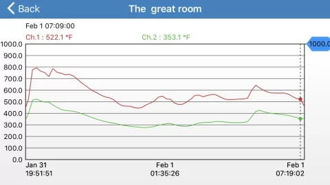

This stove is insane how long it heats the house. I had outside temps of 10 degrees last night filled the stove at 8pm went 12 hours, here’s the chart the red line is inside stove temp the green is stove top. At 5am I woke up and opened the air completely from 1/4 opened for the overnight burn I wanted to burn the coals down so I can fill it before going to work for the next 12 hours, I also took that picture at 6:30am after 10 1/2 hours of burning.

Nice, sounds like a winner. Are you burning both Regencies in this cold snap?
