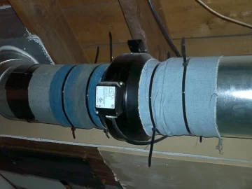

Actually, the ones I linked above ARE the industrial type. I've used one like it 24/7 for the past 8 years, and it still works just like the day I bought it. It wasn't cheap, I paid almost $200. I'm pretty sure it would easily outlast the blowers that come with most stoves.
This is the one I use.
