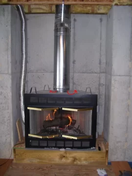

I have a brand new house and brand new fireplace that is not bricked in yet. Before I brick it in, I need to get this question answered. I am currently getting drafts coming in from around the bottom of the double wall chimney pipe just above the firebox (see red arrows in picture). Is that supposed to happen? or is there something wrong with my chimney pipe?
Thanks for your help.

Is that air cooled chimney pipe?
pen
I sure didn't know you could sit those things on OSB.
Yes, it can sit on OSB. I don't see that OAK doing much good though, not that they do anything on a pre-fab anyway.
It is normal to feel air coming down the outer layer of pipe, especially in a basement set-up. This was being discussed in another thread, they had an insert that didn't do well because of a cold air downdraft, it was coming from the outer, air cooled portion of the pipe, I think. The flue does OK because it is hot, the outer layer is designed to use cold air to cool the pipe. In the basement it's hard to have a good draft, and cold outer layer of pipe doesn't have much of a chance to draft up, it's more likely to down draft. If you insulate the chase and install the brick, the downdraft should be minimal.

As for the pipe, it's prob Air cooled and the draft would be normal.

I pulled one of these out of a foreclosure I bought. Pen, it is aircooled....IRRC, it was 8" pipe inside 12" pipe ( or maybe 10"/14". Scary pipe compared to class A. Ditto what webby said...the house may even be cooler when you have a fire because warm house air goes up the chimney. The OAK may help but I kinda doubt it.
