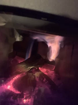

So here is a little more to last night, I made a fire specifically at about midnight because thats when the temp really started to drop and I wanted the house warm for morning.
Started it with some kindling and added 5 or 6 pieces of wood on top of that, the fire box would have been a 3rd or a hair more full. once it was lit good, I had the door closed and it was burning good, before I left the basement I remember hearing the drafts close ( i assume ) and the blower was already running. I noticed right from the start when I got the furnace, when make a fire it doesn't take long for the blower to kick in. when I started the fire the house was 68 thermostat set at 74
By 1am I could smell the furnace, that hot smell. So I went down to look, and the fire was burning pretty hard . Honestly not sure if the drafts were open or closed, just took some temps on and in the furnace and came back upstairs. just did some reading to see if I could find out what the temps should be and stuff and went back down at about 1:20. At this point I noticed the house was already up to temp , or close to it, I did check both drafts on the back of the furnace with a flashlight at that point and they were closed.
I know by 130 the house was at temp and a I had a flashing green light however there was no change in how hard the fire was burning. when I posted at 1.43 Like I say I had a flashing green light and the blower was cycling, a long cycle on for a longer period and off for a short period. the last time I went down was at 2.30 by this time there was noticeably a fair bit of wood burnt, I took the poker and kind of arranged the wood and coals so it was over/covering the grate. At this point the fire was starting slow down a bit. and at this point I said frig it and went to bed, but I did notice the house was 76
By 6am when the wife got up it wasn't running or ran at all since then and the house was down to 71.
Now you guys with more experience with the furnace then me will no, Does this seem to be normal operation.
To me this seems like a hot front end loaded burn , personally I'd like to see a more even heat over a longer period of time.
Until you said I would have never noticed as my unit I have sitting directly on the floor, but yes when the blower is on there is a considerable amount of air being pushed under the unit. The one thing I’ve noticed is the unit doesn’t really care for smaller loads like that even though it’s hard not to because it’s mild so far I find it full tilt all the time as you say as well. However this year I hooked up a baro and got a manometer and dialed the draft to 0.5 and I can tell you it made a big difference from last year I get noticeably
longer burn times and when the stat is satisfied now the flame almost looks like it dies out but it’s still going. 0.4-0.5 is the sweet spot. I think once you get that set up and running you’ll notice a difference.
Reactions: NSGUY
