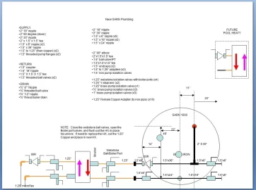

LOL....I have three in 12, 11, 9th grade....my time is coming. I ran 1.25" microflex as well and 1.25" copper, with 1.5" or 2" black iron right near the Garn itself. Do you have a heat load and know more or less how much you need to move? 1.25" is fine in typical applications....1" is a bit small.
Here's the working diagram I had for my near garn plumbing....it is pretty easy once you just get going. Don't believe the measurements exactly...this was my plan. Seems to work very well. Having Y-strainers around your HX is a good idea. Make sure you have isolation valves, drains, etc. where ever you may wish you did.

I appreciate the diagram. I will keep this in mind for the install. I printed it out and will keep it in my notebook. There is so much to learn!!
