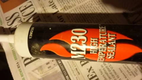

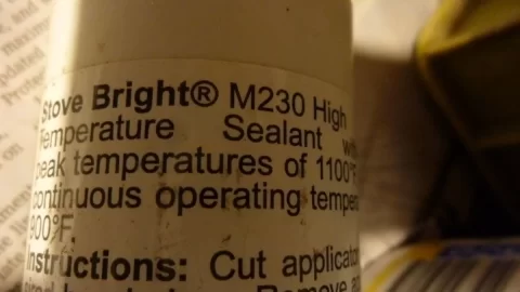

Most stove mfgs appear to be using the black rtv which is a bit lower temp than the red.
This stuff is black...I bet they are using something similar. Probably not going to the local AutoZone. ;)
[Hearth.com] new gasket, what to do with ends [Hearth.com] new gasket, what to do with ends
I'm not sure about that, I haven't used or seen their sealant. The product I have seen is black silicone. Note that Buck sells black silicone at its store for a gasket adhesive.
