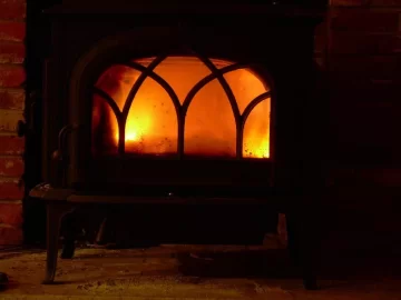

BrotherBart's advice works well. Here's a picture of our Jotul Oslo running at about 500 degrees stovetop temperature, in Rockingham County, NH.
JotulOslo
