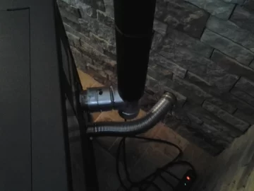

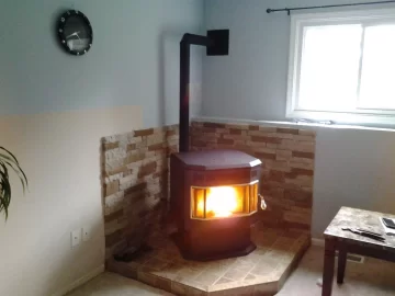

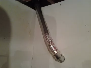

Hey guys, my name is Anthony and i just finished my install on my first stove. I just want to say this site is great, lots of info and nice people. The stove ive chosen is a pelpro bayview, i know its no harmon but a friend has had good luck with his. Anyways it replaced a gas fireplace that used way to much propane, i built the base and did the tile and stone. The stove is in the lower level of my quad level home, the OAK goes thru the wall and into the basement before exiting through the bond board i did not want two pipes going up the wall. I used selkirk 3inch multi fuel vent pipe i have 5 feet of vertical rise and 3 feet of horizontal. This is the second day of burning and so far so good.

Looks nice. I am new to this, why is there two pipes? Is one for fresh air?

Thanks guys it turned out nice i still need to paint(if your wondering why my wall is two colors haha) the gas fireplace was right there. I plan on keeping it real clean so i dont have problems, btw what brush do you guys recommend for the vent? And maybe a recommendation on a ash vac
I'm new to this too :) One is for fresh air. OAK stands for "Outside air kit" The stove uses this to breathe in outside air instead of air from inside a home.
Pics look great! Stay warm. As long as it keeps you happy warm and safe it doesn't matter what it is!

Hi Anthony, welcome to the forum! Nice install ... have you got your smoke detectors and CO monitors in place? Fire extinguisher - in the stove room but not too close to the stove?
I understand you don't want two holes because of an OAK - just wondering why you didn't look into pipe that has OAK integrated into outer channel of the pellet vent or a wall thimble with integrated outside air channel? Maybe something for a later upgrade...
I thought about going that route but the way i did it was cost effective and works great so far. And yes i have a co, fire and extinguisher in the room, that's a great thing to ask very important!
