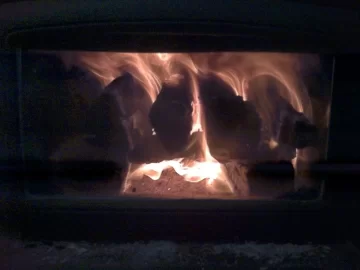

BTW, thanks to the site, I got my stove loaded right and the damper set just so, and it was 69 in the house when I woke up(usually 62), what a difference!!
Congratulation on the burning improvements. Can you post a picture or two of the current stove installation?
