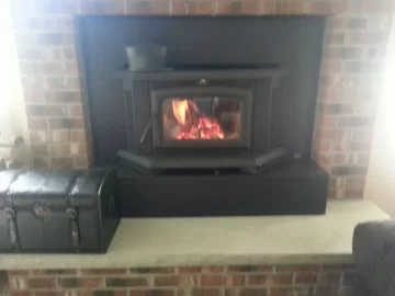

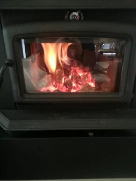

I found this great web sight after i purchased my Pacific Energy Super Insert. Lots of great info on this sight and hope to learn a lot and make new friends!. My first question is am I operating my insert correctly? I feel as i am not getting the long burns as you guys are, or maybe i am interpreting the language wrong? For example, this morning at 1015am i loaded my insert with 2/3 full of wood, at 1230 i have little wood left with just about no flame, after that i have red hot ashes for a while. At 1015 i got the wood going for about 15 min then i turn it all the way down, i see blue flame and secondary's etc. I feel as i maybe have to much draft? or is what i am describing normal, please see pics below, these are after 2 hours and 15 min. the last pics are my dog enjoying the heat :) I just hope i didnt purchase the wrong brand, i spent alot of money.

I would say bigger splits are in order. Small, dry splits burn up quickly. And try turning down the air a bit fasters, increments say 5 minutes apart.
How tall is the flue on the insert?
If you are referring to the flue length? I would say 25ft long with 2ft of it sticking out the top with the cap
That's about what I'm getting right now, but only because I want just a quick hot fire for a couple of hours to get the chill off the cold morning. If you use small splits and stack them loosely in the stove 3/4 full, then what you are getting is probably about right and that's what I've been doing lately.
After lighting, watch the fire closely and as soon as you see that the secondaries are starting to work and the chimney stops smoking outside, turn the control down about 1/2, then another 1/2 after a few minutes until you get all the way down or maybe 1/2" off. With 25' of flue, you probably will be running all the way down most of the time.
Everybody has a different idea of what burn time means. Usually it means just having enough coals to start a reload, but the stove itself could be only warm. You should be able to get 8 or 10 hours or so with a stuffed stove of larger splits with the air all the way down, but there are a lot of variables there like quality of wood, draft, etc.
