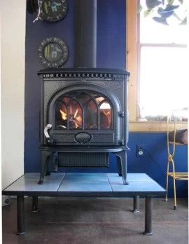

Maybe bring it up even higher then? You can store wood underneath. This could be a wood-framed platform or metal-welded with a nice tiled top. Here's a shot of jaquith's hearth.

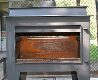

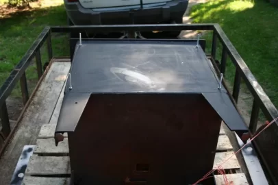

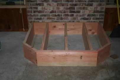

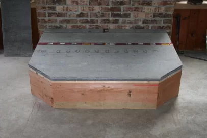

Well, Finally started the hearth buildup. Went with 2x's @ 9", and am using Wonderboard on top of that.
I have enough WB to go 2.5", since the required k-value for this stove is .84. If I'm calculating things right, that means I need 2.3 inches of this stuff. Am I close? Way off?
I've got 2 layers down right now, then decided to take a break to get on here for some help.
I got the stove back from my friend, too. Some may remember the thread about "can warping". Rebuild of the back plate came out nice. He called me just as I was putting the 2x base in the stove room. Had to drop that, and get to his house, since he was due to head back downstate for a bunch more work.
Almost forgot, he put in a bracket for firebrick in the back of the stove. None there before. I had brick in there last couple of years, that kept falling if I hit them with a split (happened a lot!).
Anyway, here's some pics, since we all know.....no pics, it didn't happen. :lol:

After looking at https://www.hearth.com/econtent/index.php/articles/k_values_what_does_it_all_mean again, I converted k to r, and came up with just over 1.5" needed to satisfy my required hearth protection. I'll probably just go ahead with the full 2.5" ( since that's what I bought) to cover any possible future stove installation.
