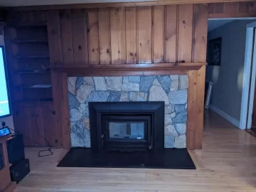

We are enjoying the first true burn after breaking in our new 8492 series Hearthstone Clydesdale insert. I self installed the unit in our main floor living room (ranch home) which wasn't too bad. We love the looks and are enjoying the dancing flames. In our basement we've had a large Timberline stove since the early 80's (bought my parents home). It still functions great but the Clydesdale will be our go to unit now. Being able to see the flames in our living room is fantastic. We were initially looking at the Blaze King Sirocco insert but chose the Clydesdale for several reasons.
First, although I like the looks from a distance, I did not like the relatively thin sheet metal face and surround material of the Blaze King which that I felt may not stand up to accidental dings (I have 8 year old twins. You never know). When I saw it at the dealer I wondered if it was really all together but it was. The Clydesdale, on the other hand, has a very solid cast iron exterior and surround which I felt would stand up to just about anything and at most require touch up paint. I'm sure the Sirocco is a fine unit, but for $4k plus, I would have expected a more solid feel from Blaze King.
Secondly, while I liked the Blaze King's auto control function we really wanted to see dancing flames from a secondary air inlet system. I may be wrong but I don't believe the Sirocco had this and, once set low, would just glow as it sends everything through the cats. With the Hearthstone unit on low it still has dancing flames from the secondary air inlet before it sends the gases through the cat system. We wanted that effect and it does not disappoint.
Lastly, the Blaze King was flush mount only and liked the idea of being able to project the unit out into the room if I wanted. In the end, I did install it projected fully and like that look best. From what I've read here, it will heat the room better that way too.
All in all we're very satisfied with our purchase so far.

Thank you for posting about your Clydesdale install. I'm in NE Ohio and considering one as well.
You mentioned you did NOT want a flush mount. Neither do I. Did you install yours as far into the opening as possible or leave it out a little further?
I noticed there's a range given for how much can be in front of the fireplace wall.
Mine is installed projected out into the room as far as it will allow. Works well and I like that look anyway.
Reactions: begreen
agreed. i just installed the Osburn 3500 insert and pulled it as far forward as the adjustable shroud permitted.
I'd do the same. Just make sure that there is at least 16" of hearth protection in front of the stove door.
