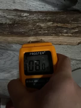

Thanks for your reply. I didn't check the wood and it is about 8-9%. I think that is pretty dry.
Did you buy the wood at the supermarket or is it old lumber scraps? Did you measure a fresh split face going with the grain, middle of the face? That number is quite low. Wood stored outside around here usually equilibrates around 15-17%.
I brought the wood from tree services around here. It is seasoned and it seems like it. I do have some fresh cut from them, and it does feel different, and the meter shows the difference too. I did test it on the fresh spilled face, about the middle of it. It is a pretty cheap meter that I got from amazon. It might not be that low, however, I do believe it is pretty dry. And I live in Boston.
Yeah I live about an hour from you. Wood stored outside around here doesn't really get below 15% without help from a kiln. That's why I asked about supermarket wood.
I'm not saying what you have isn't seasoned more than fresh wood, just that the 8-9% number is likely misleading. I bet the real number is significantly higher and could possibly be causing your issues.
Easiest way to test it is to get some biobricks and burn those in the stove. If they burn fine then it's the wood. You could also get a 2x4 you've had inside a while and measure the moisture in that to test the meter.

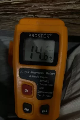

Wow, thanks a lot. Just one question, for the clean cycle you mentioned earlier. You engaged the cat? Meaning not going through the bypass, right? So with the high temp, it will help to clean the mask of the cat. I assumed. And yes, the wood we put outside is around 15, but my practice is, I would put the wood in 1-2 day before I burn it. Therefore the, reading is around 10. I have out pictures down there, the one with higher reading is right after I took it from outside.

You need to split the wood and read on the fresh split face after it comes up to room temperature
Reactions: mdocod
You don't need to turn off the stove to measure your wood properly.
