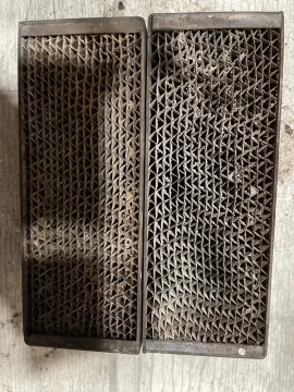

Pretty sure it is clogged. Still too hot to look at the cat. I see there is black shining inside the cat chamber. How do I clean it? Any clue?
If you engage the cats and the fires goes out, that means they are plugged up.
Why start another fire in a stove with clearly plugged cats?
You need to either remove the cats to clean them or try to reach in with a vacuum wand to clean them. Either way. On this stove design you can probably access them through any of the entry points. Remove baffles from front, or reach down through stove collar, or remove rear outlet. Any should work.
There's probably going to be black soot and creosote all over the inside of the stove, on the baffle, in the cat chamber, and likely in the chimney now as well. The easiest way to clean the stove is to first clean your cats with a vacuum, reinstall them, then start up a fire according to the manufacture recommendations:

I see these stoves with clogged up cats from ash. Even with the best burning practices. Might just be ash, not creosote.
Right! But once they are plugged and a fire smolders in the box for awhile everything else gets covered in creosote, which requires a proper hot fire to clean off.
As I said, the cats will probably be cleanable with a vacuum, which is a soot/ash issue. In the unlikely scenario that it's plugged with something sticky, then the water/vinegar mix needs to come out.

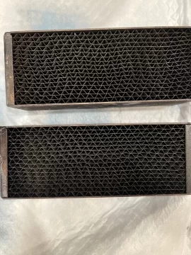

Thanks so much for the detail explanation. I have been able to stick a vacuum in and get the cat cleaned. Started a fire with full box. Reach to cat active temp and turn the cat on. Fire slow down again so I think the cat is not cleaned enough. So I want to clean the cat again by letting the bypass on to burn the rest of the wood. When it was reached to 600, I let the cat on, thinking maybe higher temp fire can clean the cat a little bit. And this time, the fire goes on and stays at 600. I will let it cool off and check the cat again tomorrow.

So, I think the cat plugs again. And yet I still haven’t checked the wood yet. However, I am thinking maybe I havnt cleaned the cat through last time. All I did was stick the vacuum and clean. It works or for about two weeks? Now it goes back to what it was. So I manage to take the cat out from the front. And this time did 4:1 water : vinegar and sock it in. Hopefully this would do the job. The first picture is before it is clean.
