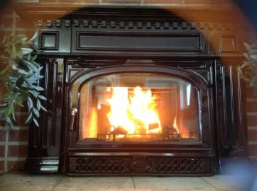

nick mystic forum member posted his install pic looks really nice, an option not to go with an insert.
I like the idea not to go with an insert as you dont have to run the blower to get the heat out of the stove if the electric goes out.
Plus a free standing stove gives you lots more options to choose from.
Here is Nick's pic he posted
[Hearth.com] New here- shopping for an insert

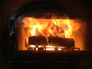

Your dog will thank you so much the night you light your first fire..... You can't go wrong putting an insert of your choice in there, gl, here is a pic or two of mine...
[Hearth.com] New here- shopping for an insert [Hearth.com] New here- shopping for an insert
this is what your capable of having in that last picture space, find an insert that you love to look at with the largest glass viewing area and then you will not be disappointed, remember, it is about loving what you have, not heating your entire house with it...

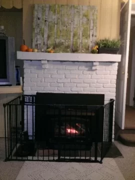

We have an Osburn 2400 insert. Its a heating beast. There are plenty of great inserts to choose from. When I was looking, this unit was the largest firebox I could get for the lowest price, and it has proven to be a great unit. We also have the Kidco hearth gate. Our fireplace is in the busiest room in the house and we have two little kids. Here's a picture. The hearth gate is a bit invasive to the space but it was worth the trade off for us.
