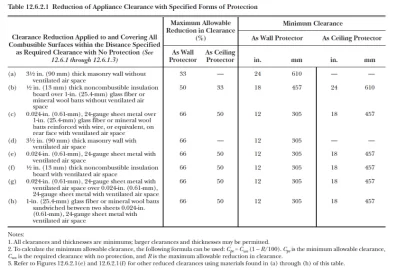

Combustible material is measured from the first combustible, ie: the wood or sheetrock, behind the durock. Is a shielded wall necessary for this installation in order to reduce clearances? There are other stoves that have closer clearances and will perform well. In a tight new house you may want a less radiant stove.
Note that as soon as the flue exits the room at the ceiling it must switch to chimney pipe from connector stove pipe. Have you considered using double-wall stove pipe instead of single-wall? That would reduce stove pipe clearance down from 18" to 6". Chimney pipe clearance is typically 2".

Thanks for the info Dobish. Glad to hear that you like your 2040. I found the owners manual on line, but it seems that the flue pipe and the stove clearances both have to be satisfied, then take into account if surfaces are protected or not. Blaze King is similarly called out. I find neither has simply called out the corner specs.
