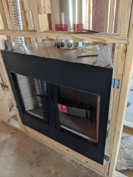

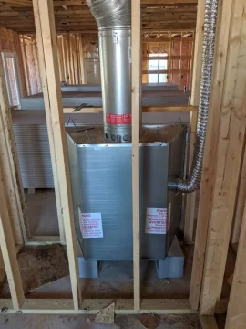

Builder installed a Hearth and Home Technologies heatalator EL36 into a new home and I want to install a wood burning insert. My understanding of what I have read, I will need a stainless steel 6 inch liner dropped down into the new 8 inch existing liner and a new cap. The fireplace has a slight offset, so liner needs to be flexible. I will probably opt for the Drolet model DB03125 insert that my local Lowes offers for the price. Question is, can this be installed into a prefab unit such as the model I have, and where is the best place to order everything to complete the liner install?

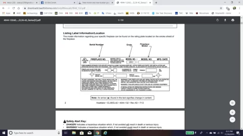

You CANNOT install a wood burning insert in this model.
That information is on page 2 of the manual:
[Hearth.com] New home and new builder grade prefab fireplace

The manual for your fireplace clearly says no insert. There really is no way around that
Understandable. If you have your install inspected, the manual will be asked for & it will probably not pass.

They do have an exception in the statement:
DO NOT USE A FIREPLACE INSERT OR OTHER PRODUCTS NOT SPECIFIED FOR USE WITH THIS PRODUCT.

Considering this is new construction, would the builder exchange this unit for a high-efficiency EPA ZC fireplace? That could be a nicer solution. It would afford a larger firebox, bigger fire view and the potential to duct heat to another part of the house.
I am sorry I just read the manual. Page 33 says it can be done.

You need to have them send you an official list of specified inserts and choose from them
I am wondering WHY they would contradict their manual, even though I haven't read that part yet.
They didn't. They warn against using an insert not specified for use in this product. The Drolet is an example of such an unspecified stove.
