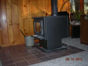

My wife and I have a 1500 sq ft home with a full, mostly finished below-grade basement, 3000 sq ft total. The house was built in 1956 and due to many projects I have mostly rebuilt it with 6" walls, R-19 fiberglass, new windows, original solid wood doors, about R-40 in ceiling/attic. We heat the main 1500 sq ft level only with the small wood stove in the picture. The stove was purchased in 1990, the brochure rates it at 55,000 btuh maximum output, and the sticker on the stove shows average output range 13,239-22,532 btuh. The stove has no difficulty keeping the house warm, even at common winter lows down to -35F, and even during one winter period several years ago when temperatures dropped to the low -50'sF.
We keep the house typically at 70F in the main living areas, cooler in the bedrooms, and we keep the basement at 45-50F with electric heat, no other heating other than normal living for two of us. Our total electric heating bill is less than $200/year, and that includes the backup electric heat for the entire house if we take off for a couple of weeks during the winter.
We burn 4-5 cords of aspen each year, which amounts to about 6-8 btu/sq ft for 1500 sq ft average based on 240 days (8 months) of heating. The firewood comes from our own trees.
I have nothing against larger homes or different life styles. I am amazed though at the surprise or shock some people express at the amount of their heating bills. As my father-in-law commonly said, "When you play you pay." For every action there is a reaction, and one reaction from large homes is higher energy costs.
