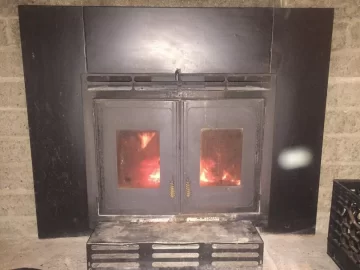

Hi all, I just purchased the home about 5 weeks ago and it has a wood stove insert. I would really like to use the stove to heat my house, its a ranch with an open floor plan.
I am having trouble getting the stove to put out much heat, room barely gets above 65.
For starters can anyone tell me what stove I have? I cant find any information on it.
Here is a pic

It's hard to say what it is. There's lots of stoves out there from the 70's and 80's that were only sold in small areas. Anyone with a welder could fab some up and sell them.
It's very inefficient, and likely does not have a liner, it's probably just pushed into the fireplace. Not code compliant or safe. Have you had the system inspected by a pro?

Unfortunately a lot of these old inserts had a very large rectangular flue outlet that made them very hard to line. Often there's no room for the adaptor that's needed to make the connection.
Best advice to you would be to update that insert, have chimney checked & install a good liner for the new updated insert.

I know my old buckstove required an 8 inch round liner it seemed to draw better once I installed it. Does your stove have any damper controls? What controls the blower motor speeds if it is a multi speed set up. I would make sure your not blocking off an intake for the blower when you reinsert the stove I saw where you said it blows a lot more air when you have it pulled out.

Ok I couldn't tell too much from your picture. Are you new to wood burning or have you owned a wood stove previously? You may need to close your damper some once the fire has taken off this way you dont have so much draw and some of your heat will stay in the stove instead of going up the chimney.I would recommend a thermometer for you stove though just to keep an eye on it as to not over fire it.
