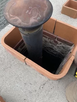

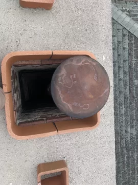

New member and first time homeowner here.
I have a wood stove with pipe that was ran through the chimney. Got up there to inspect it and clean the stove pipe and realized that the chimney opening was not covered and has likely been collecting water. Luckily, there is a drain in the back of the chimney so no water has been pooling in there.
What should I do to cover the opening around the stove pipe? If I cover it will dangerous heat build in the air pocket between the pipe and chimney?

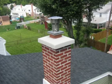

That is an illegal installation. Black stovepipe can not be used in a chimney. It must have a stainless steel liner and it should be insulated, especially in an unlined chimney. The top cap for the liner will cover the flue top.

It also means that if there is any issue related to the stove or chimney the insurance will not cover it. The bottom line is it's just plain wrong. Added moisture from rain will just accelerate corrosion of the stove pipe. It's a potentially dangerous situation for several reasons.

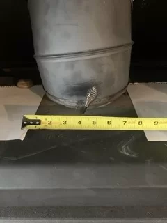

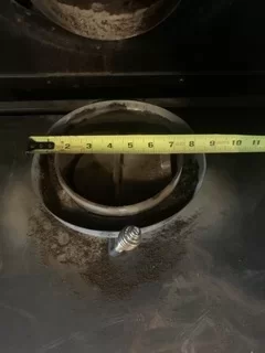

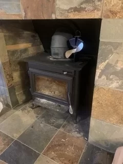

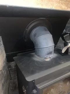

What woodstove is on the other end of the stovepipe? Can you post a picture?
This looks more like 6", but it's hard to judge the scale. The chimney throat appears fairly large. Unless there are offsets it should be easy to drop an insulated liner down there. Do you know what the ID is for this chimney?
Also be aware there are insulated oval liners that will definitely fit if round won't. They use a tee that has a round fitting for attaching the stovepipe to the side, then oval fitting for attaching the liner to the end. When I did mine all it took was knocking the top clay block out, run the liner down with the tee attached, attach the stovepipe, put on the top plate & weather flanges & chimney cap.
Yes, ovalizing or preinsulated oval is an option if needed. Once we have the current chimney ID and we know what it is connecting to we can make recommendations for liners.

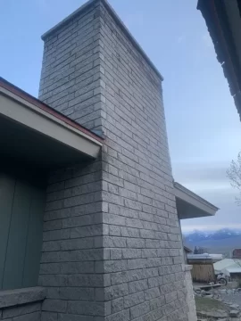

Please correct me where I'm wrong but from what I can gather, I need 15' of either 6 inch insulated chimney pipe or insulated liner to get 2' clearance from the top of the chimney. Coming out of the stove, the flu diameter is 6 inches and there are two 90 degree elbows of stove pipe and then the I would install the chimney pipe running up the chimney. I'll need a custom cover to surround the chimney pipe where it exits the chimney due to the size of the opening on top of the chimney.

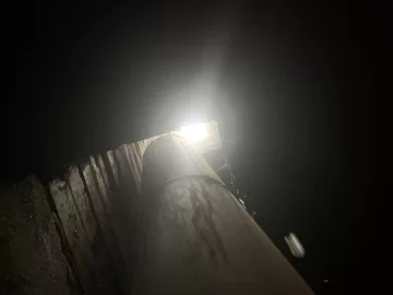

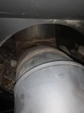

I'm not sure what a chimney ID entails but I attached a photo of the chimney from the outside and attempted to get a photo looking up it parallell to the current chimney (stove) pipe.

You're addressing this just in time. You can see the corrosion of the stovepipe happening. That's why it must be stainless. the inner flue collar connection looks like this is a 6" flue outlet, but the outer ring is confusing.
Do you know if the alcove enclosure for the stove is solid masonry or if it is large tiles over a framed structure? If it's wood-framed, that is another strikeout.
Do you know what stove this is? Is there a labeling plate on the back?
See if 15' would be enough if you can find a manual.
The elbow and possible elevation above sea level might make the stove need more to burn well and prevent smoke roll out.
The collar damper has me wondering if this is an old 35:1 stove. If so, there may be no secondary combustion and a stove less fussy about flue height.
