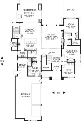

Here is the plan, will likely make changes, but not much with the great room/kitchen orientation/layout. It is 10 foot ceilings but the great room is lofted. I definitely want wood, preferably freestanding stove. If push comes to shove i will just make an insert work. Im seriously thinking of moving the master wing from the second level down to the first, I dont need a gym and sauna taking up sq.ft.

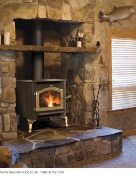

Actually, looking at Alcove requirements for the large stoves that i need, there is no way I'm putting a TV on the wall 8 feet up. Only option is to do an insert, or put the stove in a corner and the tv on the wall. I dont understand how you can get close tolerances on a insert but not on an alcove, if using the same non-combustibles for alcove.
Kuma also confuses you by showing this picture but their alcove requirements are 90inches (to include height of stove) That's not 90inches.
[Hearth.com] New House Plan - don't want insert - how to position stove?
84" vertical clearance in an alcove is common, but not all stoves have this requirement. Take a look at the BK Ashford. In the Kuma brochure picture that is ok as long as the top of the alcove is completely non-combustible. The mantle clearance however is perhaps dubious.

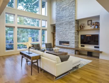

I've narrowed it down to moving the stove to a corner hearth, or doing an alcove with the stove to the side of it. It's hard without the actual blueprints to figure the layout. Using these online blueprints I'm just guessing on the space I have to play with.
I'm having trouble matching up the photo with the floor plan, unless one is a reversed image. If I see what I think I see, I have no trouble deleting the gas fireplace and all that imitation stonework and installing a stove in its place, leaving the media center as is. Or, if you prefer, just reverse the location of the media center and the stove. As noted, go straight up through the roof with the exposed flue. Some people paint their flue to match the stove.

Skip the fireplace and put a stove in front of where the fireplace would be, or put a fairly wide alcove in place of the fireplace. The put the TV where the media area is. Then you can watch to tv or the stove. Watching a stove is better than tv for me at times. A nice ceiling fan hung at proper height in the great room, and you're all set. That is what I would do anyway. Each has their own preference. If you do an alcove that is not super tight around the stove, I don't see a need for a fan, but I would still get one just in case you want to push more heated air around. A ceiling fan will move heated air real nice. Look into ceiling fans that have remote reverse feature. Getting up there to reverse flow each season would kinda suck.

Here is the full plan.
https://www.houseplans.com/plan/410...-bathroom-3-garage-contemporary-prairie-39549
Obviously finishing and final design are all changeable and the pictures are of a finished home with small adjustments and top end finishes, looks like they flipped the FP and TV area in the great room. Home will be on a lake, so I agree with the vaulted ceilings and windows, it just makes sense when the focal point of the home is the backyard and lake. It's will be our year round full time home with kids. Basically my only home between when we build and retirement. Lake/back windows face east. I will have R60 in the roof for sure, we will see how much we can do on the walls. Basement/foundation will be ICF. I'd love to heat primarily with wood, but due to the size and design of the home, it likely will just be supplemental and ambiance. I've thought about going the wood furnace route w/ it tied into the duck work but after reading countless threads it sounds like more of a hassle than anything. I would rather have the tried and true standalone stove with/radiant and convective heating in the main area (living and kitchen).
