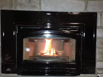

I am first time wood stove insert owner / burner and I just got my Napoleon EPI3 installed last week (interior chimney). My chimney had a clay liner (fair shape), and I ran a SS liner down it, it was a tight fit, but it worked.
The temperature has been a bit odd for this time of year, but I couldn't wait any longer to try the stove out. It was in the high 50's yesterday when I did my first burn. The manual mentioned that it would be difficult to get a fire going, due to the moisture in the firebrick.
I put some paper that I crushed into a ball in the middle of the stove, and put some fireside kindling wood all around it. I left the door open slightly until all the paper burned up (it started to smoke a bit, so I shut the door), and then once the kindling wood was going decent, I place two cedar logs that I cut earlier this year (pretty dry wood).
It took a while for the blowers to kick on, but once they did it was a very good heat source :), I was very happy.

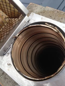

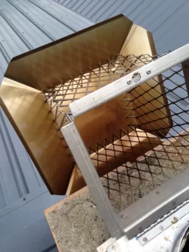

I decided to go on the roof, and check the liner, and see what it looked like the next day (today). It was brownish gold on the inside as far as I could see (sticky feeling), and the top of the chimney cap was the same way. I wasn't for sure how normal this was? I assume that brown sticky feeling is creosote? I always thought creosote was black / tarish looking.

Yes, that tan colored sticky stuff is creosote. I have never inspected a flue after a first small fire but it seems like a lot of buildup for a single fire. The only place I have seen that rapid a build has been on the outside of a pot over a camp fire where the water I was trying to boil was holding down the temperature of the pot as the wood smoke hit the surface.

As long as you are burning fully seasoned wood the build up should be minor. Congratulation on the new insert. Keep us posted on your progress and thoughts on this model.

Yeah no issue on a first burn. Learn here how to burn it hotter and keep an eye on it once a month and you will be fine. That film of stuff will dry and become dust with future hotter burns.
BTW: You are gonna love that cap. I have two of them and they are the nuts.

That residue likely came from the cedar you burnt. If you cut it earlier this year, there is very little chance it was dry and seasoned enough. Cedar is full of aromatic compounds and has a very long seasoning time. As a person new to all this, get yourself a moisture meter, split some of that wood in half, and test the fresh split. It should be well under 20% to cleanly burn cedar.
