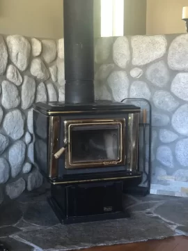

I also scored this for free with 12 feet of double wall today. It’s going into a cabin build I’m doing. Picked up the pipe today. Will grab the stove in a couple weeks.
Got the wood stove bug again! Love it!

Nice score on the old Super.
