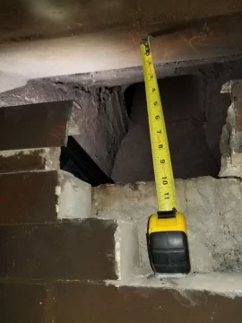

Question: how hard is it to run the liner from the bottom up with it being insulated? its a large terracotta flue around 13x13 pretty much a straight shot with an offset at the bottom between the damper cut out and the bottom of the flue. I really don't want to fight with the liner at heights coming from the top down.

Hard to tell from a pic how bad that offset is at the bottom, but some liners (like my HD Roundflex) are supposed to be able to turn better.
You might be able to incorporate an elbow at the bottom, but the sweeps here can advise you better on that, and about the liner touching the smoke shelf.
The offset doesn't look too bad but an elbow may help. Otherwise Woody is right, get a pulling cone someone on top with a rope. We use a hoist but a rope will work. Pull it up through the top plate and attach it at the top. Then cut the bottom to length.

This doesnt look bad at all. I was going to offer to come help but looked up how far away and 5 hours is too much.
Its hard to get any sweep or installer out this time of the year, its their busy season, that's why I scheduled this over a month ago. They left me the SS heavy flex liner, just need to insulate. The offset isn't too bad maybe 8" over a 3' length, at most would need a 45*.

You would get a 15 or a 30 not a 45. And use the insulation but make a metal plate to cover over that. And yeah we are scheduling well into December now
I pulled my insulated 6" liner up the chimney last night with just my 17 yr old son feeding it from below. With the old flue liner knocked out, I had an 8.5" x 12.5" wide opening. Fashioned my own pulling cone from a 45deg elbow purchased at home center. Put a threaded rod through the top part just below where I formed a cone, sliding a chain on the rod. Rope dropped down from the top. Took 15 min with him pushing and me pulling and no real problems at all. We had about a 30deg angle to navigate from below to get past the smoke shelf.

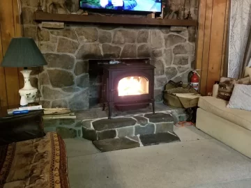

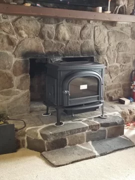

Pics of the new stove, I extended the hearth so its clear of sitting in the fireplace, finding rocks that work is a real bi!$#

Running and cruising at 400-650 is normal. Temps up to 800 are ok but if your thermometer is off or you hit those temps too often I'd say you risk shortening the stoves life. 850-900 is too much for me. No parts of the stove should ever glow.
Very nice looking setup. Keep the stovetop below 750º and all should be well. And don't ever use the ashpan door for starting the fire.
Sell the ladder on craigslist for $350 if you don't need it or lack the storage space. That increases your savings. Or you keep the ladder so that you can check the cap annually for cleanouts.
