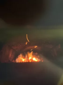

Ok- so I just turned it back on, set to stove temp - again took three cycles of pellets into the burn pot before it ignited- will post picture of flame - which in my estimation looks more like a stove that’s about to just down, as opposed to just lit..

To my little brain, you are describing a dirty stove
Do a complete cleaning air intake to exhaust termination
All hidden ash traps to Clean all the holes in the burn pot
